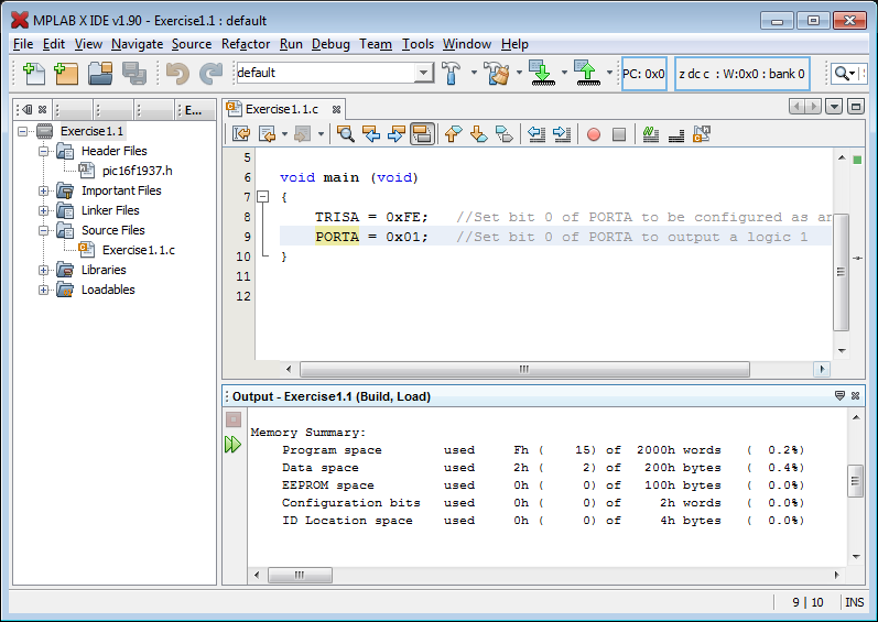

Linking is the last phase in making a program which will run on our PIC microcontroller. The linker is a the part of the compiler toolchain which will "link" together all the compiled code into raw binary data the PIC microcontroller can execute.
The linker stage normally spits out a report of the amount of memory your code will consume on the specified target microcontroller device.
Memory is broken down into several sections:
  • Program space - Memory in which your program is stored ready to be executed.
  • Data space - Memory in which your data variables exist, gets reset every time the device is powered down.
  • EEPROM space - Memory available to store data variables which will be retained during a power down.
  • Configuration Bits - Some basic settings to tell the device how to startup and run.
  • ID Location Space - Memory available to store unique IDs or other user data to help detect the version of firmware etc.
